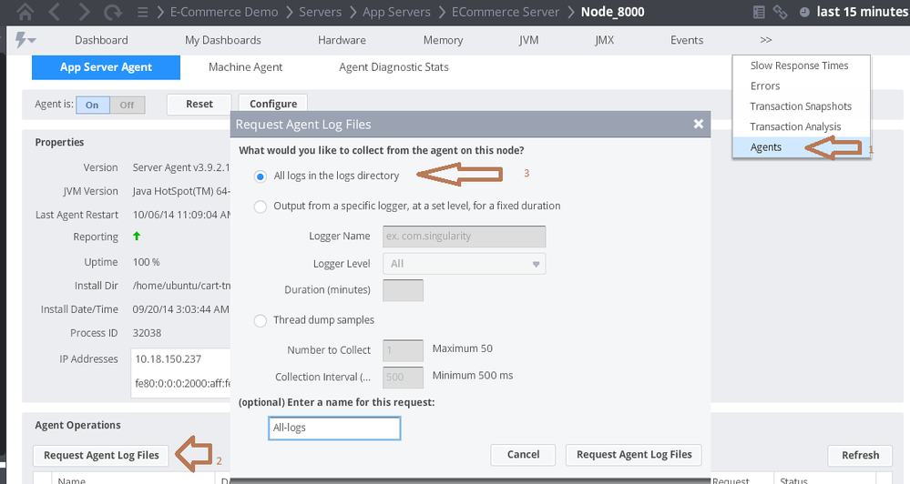

- Can you provide agent logs for case-1 node captured from UI as referred in below screenshot:
