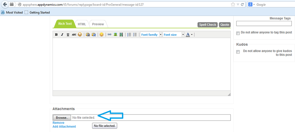

Hi Brett,
You can attach files while you respond using the attachements sections as referred in screenshot below, if you have any concerns posting here the logs, you can send the logs to akumar@appdynamics.com :
Thanks,
Arun
