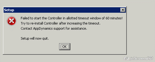

I have an issue at customer. After installation of new 3.9.0.2 release on Windows server 2008 32 bit, controller are not starting.
I've attached screenshots and logs below.
Controller runs as administrator.
Please help us to solve this issue.

Hi,
Launching with these parameters are the same result. I've attacheched scrshot and hosts file.
Restarting of server and intallation of controller made repeatedly.

Arun_Dasetty
Super Champion
Hi,
We see errors around mysql db connecion and other errors in previous server.log , but the main issue seems to port conflict issue as per startAs.log content, make sure 4848 port is not use, by default controller runs on Glassfish server instance:
There is a process already using the admin port 4848 -- it probably is another instance of a GlassFish server.
Command start-domain failed.
