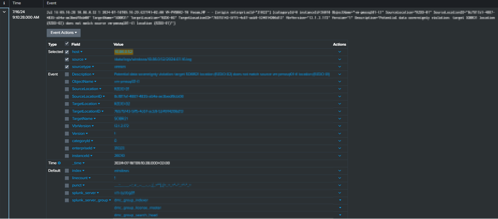

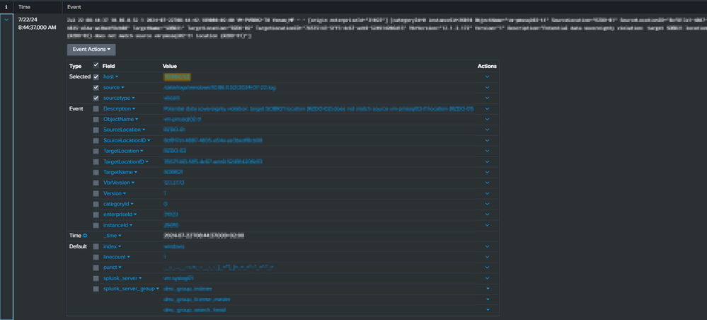

The Veeam Backup & Replication Events (VeeamVbrEvents) Data Model requires the "original_host" field to be in events.
Looking at your screenshots, it looks like that field is missing from your events - I've come across this issue too.

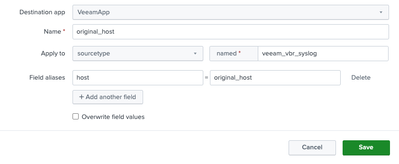

SC4S was actually setting the "host" value for each event correctly, so I was able to add a Field Alias instead - set to apply to the veeam_vbr_syslog sourcetype and set host = original_host like this:

your suggestions sounded good and I created a field alias for host to original_host with the source veeam as follows
Unfortunatelly this didn't help. Do you have any other ideas or did I something wrong?

I think so! Looking again at the screen like your Field alias is applied to a sourcetype of "veeam" not "veeam_vbr_syslog" - suggest you check that
The Data model expects sourcetype="veeam_vbr_syslog" - is that the sourcetype applied to the Veeam data coming in?
topgun
It works now. Thank you very much

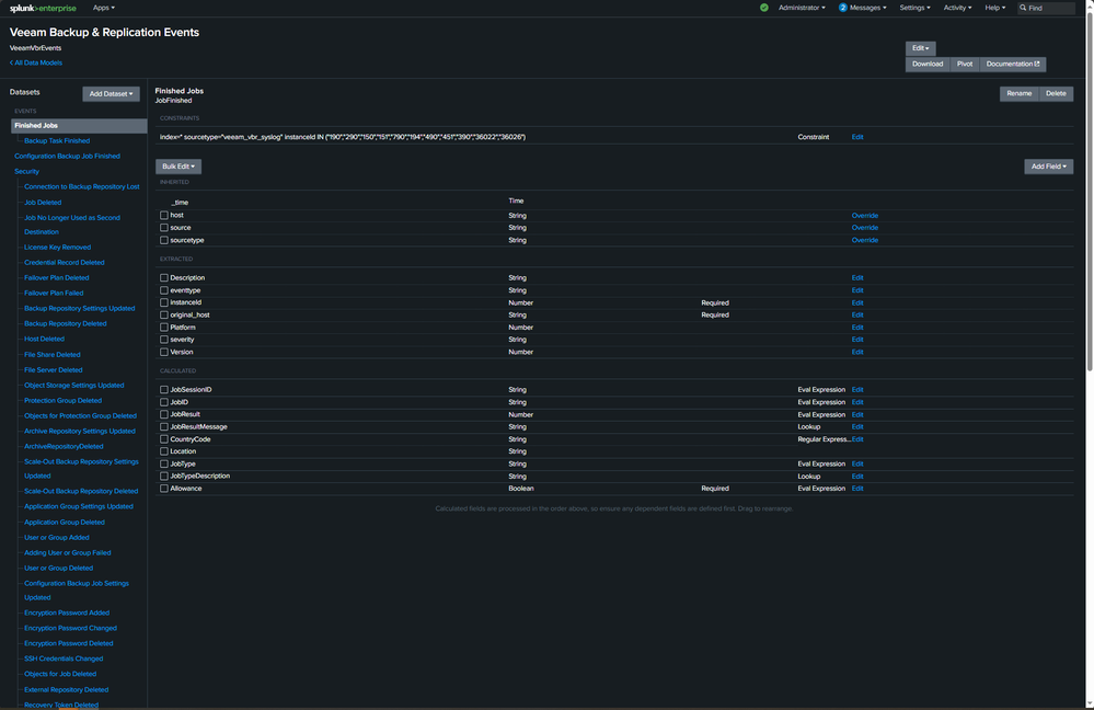

Apps are empty either because the data they need isn't present or because the data can't be found.  You've shown the former is not true so it must be the latter.
Confirm the data is in the index(es) where Veeam expects to find it.  If Veeam uses a datamodel (I suspect it does) then your data must be tagged so it is found by the DM.  Look at the DM definition to see which indexes and tags it needs.

from my point of view the index and the datamodel fields are looking good.
richgalloway
The datamodel is looking for specific values in the instanceId field, however, the screenshot does not show an instanceId field exists in the data.  Therefore, the DM will return no results and the dashboard will show nothing.

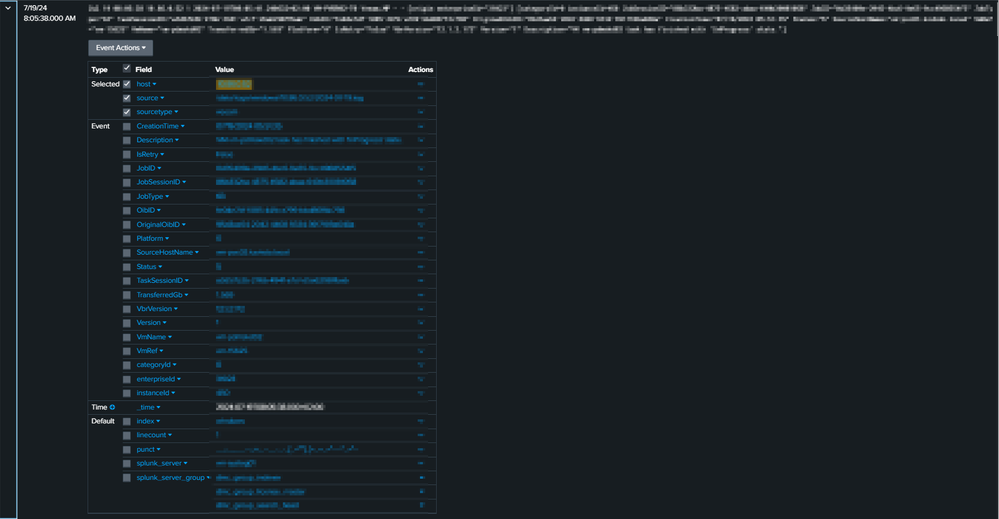

you are right but there are logs which have the instanceid field.
richgalloway
That event does indeed contain in instanceId field, but the sourcetype may not match the "veeam_vbr_syslog" value expected by the DM.  It's hard to tell from the obscured screenshot.
Everything in the "constraints" section of the DM must match your data for it to be found by the DM and appear in the dashboard.
