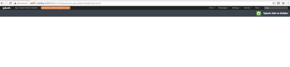

I have installed the Splunk Add-on Builder and CIM components in my test environment. The plan is to develop an app for a specific piece of software; however, when I first load the Add-on Builder app, it pops up asking whether I want to send feedback to Splunk. I check the box appropriately, but then the tab_home page loads but there is no real content. I can see the header saying Splunk Add-on Builder on the right side of the page but the content below is empty (see below). I have tried to reinstall and remove every fragment of the existing installation, but it doesn't make a difference.

Found the issue. So I looked in the splunkd log and found it complaining about a role that did not exist. Once I created the role the app began working. Very strange because the role wasn't even related to this app.

Fixed it for me too - odd issue. ran this search
index=_internal  component=AuthorizationManager
and created the missing roles with no capabilites and the page loaded straight away

In my case it was the winfra-admin one. However, looking at the log it should give the name of the role that is missing.
