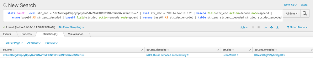

I just validated this feedback from the author of this app:
You can try this:
| stats count
| eval str_enc = "dzAwdCwgdGhpcyBpcyBkZWNvZGVkIHN1Y2Nlc3NmdWxseSAhIQ=="
| eval str_dec = "Hello World !!"
| base64 field=str_enc action=decode mode=append
| rename base64 AS str_enc_decoded
| base64 field=str_dec action=encode mode=append
| rename base64 AS str_dec_encoded
| table str_enc str_enc_decoded str_dec str_dec_encoded
Basically if you see a similar output as the attached screenshot the problem should be in the data passed to the command.
I just installed it on a Splunk 6.5, no config at all on a CentOS 6.5, and it works.
So, I went ahead and validated this. In a new install of splunk, I added the app and it all worked exactly as described.
I'm still reviewing the sample you gave me to validate if this is an issue with your install (permissions or something) or the data itself. In parallel, I'd appreciate if you can let me know the results of running this command on a clean install of splunk.
