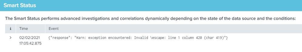

I have now upgraded to your latest version and I still have the same anomaly. If it helps with troubleshooting, I've taken some snapshots:
Please feel free to PM be if you prefer.
Thanks, Mark.

Perfect, so as you can see this is not a false positive, TrackMe is detecting a quality issue in your data, multiple format match means that the sampling detects a given format as shown in the screenshot, in addition events not matching that same format.
A proper sourcetype should be matching the same type of events respecting the same type of data under the same format ideally, this is what ensures the data sampling feature.
So it's a true positive.
If you click on "Show latest sample" this opens a search UI, which shows the events that were sampled and the format that was detected, if you checkout these you will see that there are events not matching the other format.
So you can:
- Click on the disable button on the right which will disable the sampling feature for this data source if the quality issue cannot be fixed
- Potentially you can create a custom model for that data source, if this makes sense and that depends on the data
If you disable the feature, then run the Tracker now in the main screen and the data sources will go back to the state it would without the data sampling.
