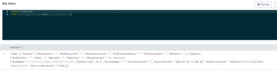

I m using Splunk DB connect to get data from DB, I get three values from the DB as follow :
- Event's ID
- Json Data
- creation data of events
There is the result, how can I remove the "rawjson=" to ba able to get this data on json format ?

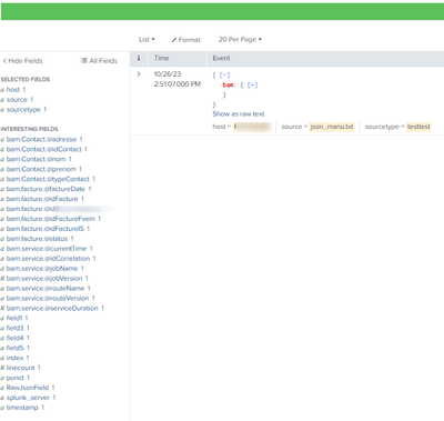

If I copy this ligne on notepad and manually import it on splunk I get want I want to have (I used the default source type)
Each value is extracted so it's perfect

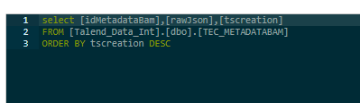

2. To automatiquely get the new logs from the DB server I decided to use Splunk DB connect ( maybe it's not the best choice ? )
So I configured a new input in the Splunk DB connect to get the value from the DB table

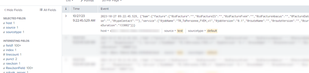

 But now the data are not indexed on json format as shown below
How can I get these datas on json format as shown on the first and second capture ?

I did the change, I get the value below but it isn't in json format ? each value still in the same field (like @idfacture; @idfactureABC; @routename)

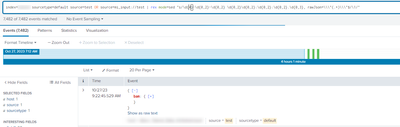

I tried that to remove the timestamp and it's work now but don't know if it's correct or if I need to optimse that ?

Hello I just tried the rex but I still not json format, Do I need to export the query in json or something like that ?
