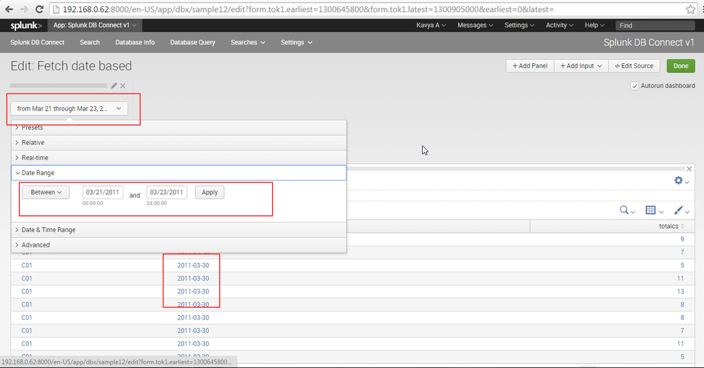

Hi,
I have 2011 mar to 2015 mar data. I have applied time input filter on Transdate column in my database. In the time input filter, I have selected date range between 2011-03-21 to 2011-03-23. However, I am getting all data for 2011 to 2015. I am not getting correct results regarding selected value (2011-03-21 to 2011-03-23). Please help me. Thanks in advance. The code is as below. Please check it once.

srisahitya_v
Communicator
  1. check the retention period on data. whether it was deleted 2011 data?
  2. if you are getting "splunk deamon error: timed out" then increase "splundconnectiontimeout" and try again.
kavyaa
I have checked. I have 2011 mar to 2015 mar data. What ever i selected value 2011or 2012 or 2013 , it showing all 5years data
srisahitya_v
Communicator
let us know, as per your retention period this particular day bucket in which form?
1. hot
2. worm
3. cold
4. frozen
5. thawed
