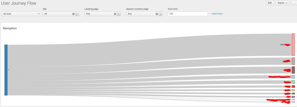

This is a picture without any filter (all links are cut correctly:
But after setting the filter in the landing page for the first entry "test....." the Web.uri's on the right sight shouldn't be cuted off.. the should be the whole uri like /linkA/linkB/result.html. So my idea was to allow the rex command only if the landing page filter is set to "Any":

I think you misunderstood my question :/. I don't want to set any field. When I'm at the user journey flow I have a graphic. When I set all filters to "Any" especially the landing page filter the rex command should cut off the ending from the landing pages that I get just the first part. If I set the filter for the landing page to a value the rex shouldn't cut off the ending for all Web.uri's.
I'll upload a picture to my question for a better understanding.
