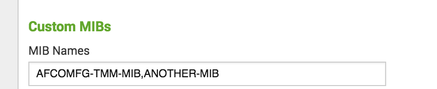

And, yes, the MIB is specified in the "Custom MIBs" configuration box. But I don't have another custom MIB, so the AFCOMFG-TMM-MIB is the only one in there. I don't think I must have multiple MIBs in that configuration item but I will try to specify another one in the egg.

Tried with:
Custom MIBs : MIB Names  = AFCOMFG-TMM-MIB,RFC1213-MIB
and
Object Names List = AFCOMFG-TMM-MIB::Temperature2.0,AFCOMFG-TMM-MIB::Temperature3.0
Getting the same error messages.
