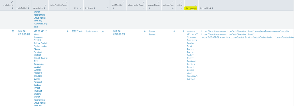

Hi, I'm working with Threatconnect lookup created by their add on, one of the kvstores has one field within a collection, the field name in the kvstore definition is tag, that field has multiple values for tag.name.
For example, one row will be like the following:
webLink: https://app.threatconnet.com
rating: 5.0
confidence: 80
indicator: 101.1.8.1
tag.name: malware
.name: Corebot
.name: Ransomware

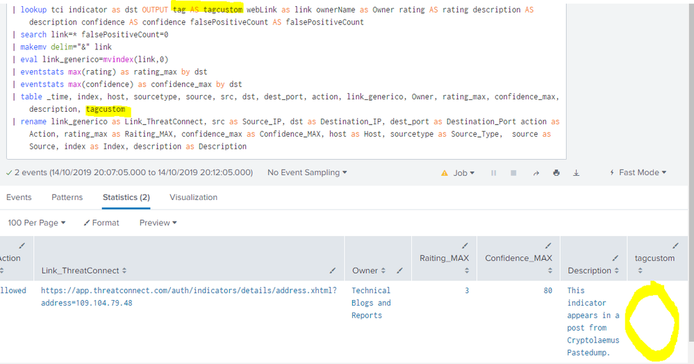

The field tag is part of the supported fields, however, I'm not able to make searches over that field using lookup command
If I use |lookup tci indicator as dest OUTPUT tag as tagcustom | table dest, tag the tag column is empty.
If I use |lookup tci indicator as dest OUTPUT tag.name as tagcustom | table dest, tagcustom I get an splunk error "Error in 'lookup' command: Could not find all of the specified destination fields in the lookup table."

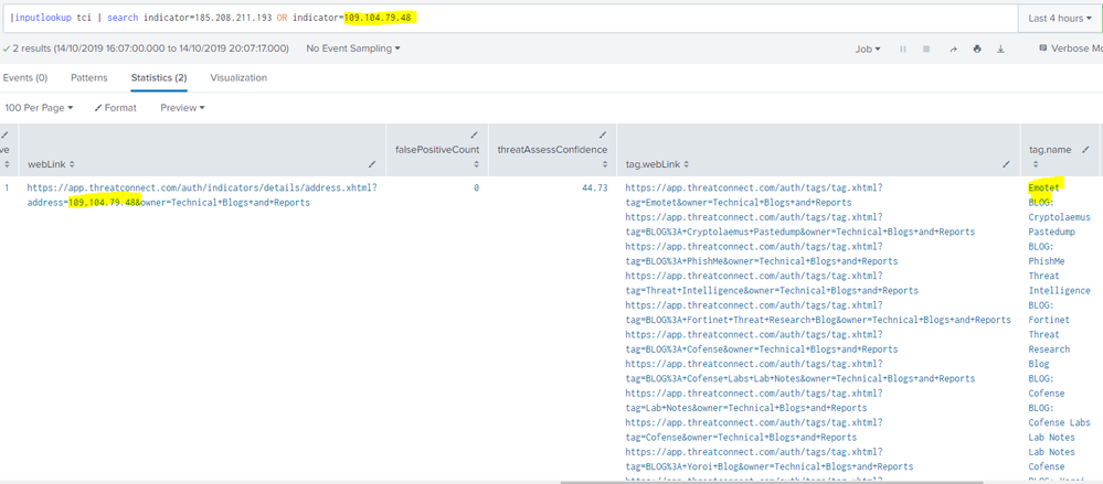

Notice that the tag field has values because when I use the command
|inputlookup tci |search tag.name=Corebot I get information in that column.

When I use inputlookup I'am able to see the tag.name.
If I try to use the lookup command I get no information in the tag column:

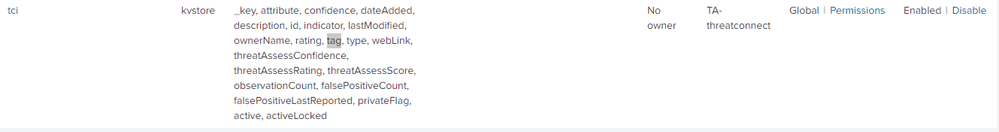

Thanks for your answers, I just want to let you know the definition of the kvstore is the following:alt text
They just define tag, but I know that inside tag there is the name. However, when I use tag.name, I get "Error in 'lookup' command: Could not find all of the specified destination fields in the lookup table."
