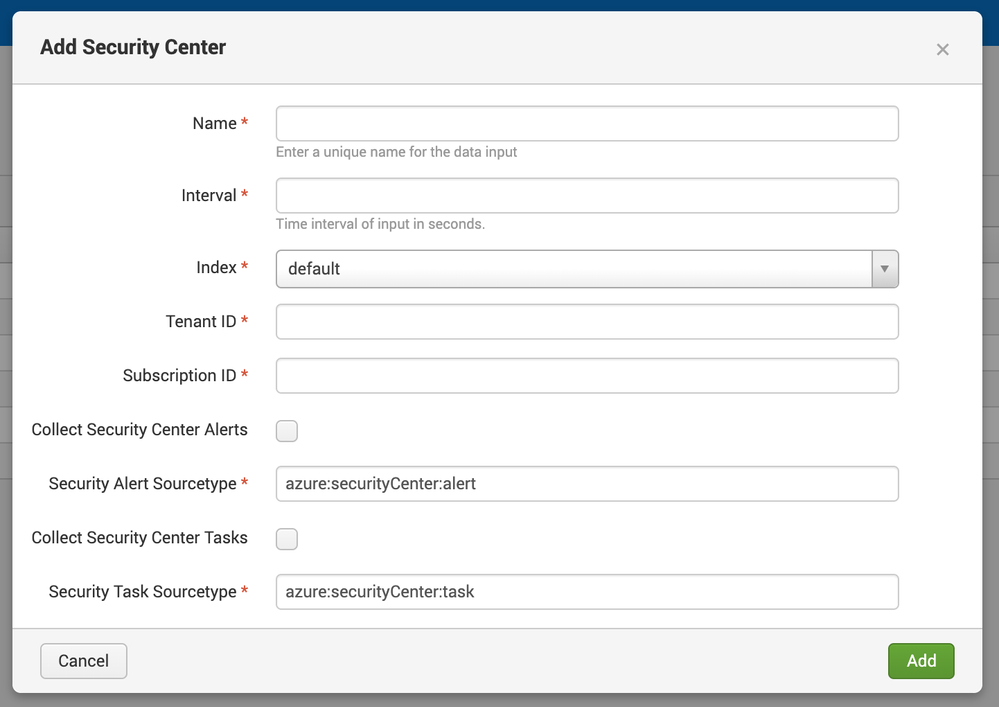

I noticed that you can only add 1 subscription to the configuration. Will there be the ability to add multiple subscriptions from a single tenant?

Yes, you can get data from multiple subscriptions. Here's how:
  1. Grant your Azure AD application registration Reader access to your subscriptions. If you are using the Topology input, you will need to grant Network Contributor access. For more information about required permissions, see this spreadsheet -> http://bit.ly/Splunk_Azure_Permissions
  2. Create a new input in the add-on and supply the tenant ID and subscription ID.

and how do i get all my 100 subscriptions at a time? do i need to create 100 of those inputs?

The API used behind the scenes works at the subscription level, so yeah, you need an input per subscription. However, you don't have to use the UI to create the inputs. You can create inputs via inputs.conf.
