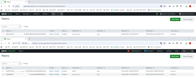

xvalette
Did you try to use a token with a "mcp" audience ?
hk_baek
Engager
Yes, I’m using MCP.
I tried following this YouTube video: MCP Server on Splunk Cloud Platform Demo
Does it work well on your side, xvalette?
