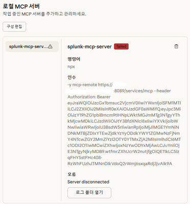

Hello,
I have a question regarding the Splunk MCP Server APP provided by Splunkbase.
After configuring Splunk Enterprise On-Prem as below and proceeding with the setup, an error occurs.
a. We have installed Splunk Enterprise 9.4.4 with the Splunk MCP Server APP.
b. Roles, users, and tokens have been created.
c. When configuring the MCP server in Claude and running it,
the following error occurs:
Is there any additional step I should take?
Thank you.

hi @livehybrid
  1. The MCP server I used was downloaded from https://splunkbase.splunk.com/app/7931.
  2. I configured it as shown below, but the same error still occurs..
  "mcpServers": {
    "splunk-mcp-server": {
      "command": "npx",
      "args": [
        "-y",
        "mcp-remote",
        "--header",
        "Authorization: Bearer eyJraWQiOiJzcGx1bmsuc2..."
      "env": {
        "NODE_TLS_REJECT_UNAUTHORIZED": "0"
3. Splunk was installed in a VMware instance running on a desktop PC.
Thank you.
