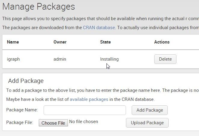

I am currently exploring the R App for Splunk. For a specific analysis purpose, I need to use ‘igraph’ library. I tried several times and didn’t work the code out. When I tried to add ‘igraph’ package in ‘Manage Packages’, the “state” is always “Installing” as you can see from the attached pic.
Could you please advise me whether this is because that this App currently does not support the ‘igraph’ package or maybe I didn’t configure the App correctly?

Hi xiangtaner, I just tried to install the igraph package on my installation.
It worked without any problems:
  1. entered the name "igraph" as a package name and hit "Add Package" button
  2. the package should appeared in the list of packages (state="Not Installed")
  3. hit the "Install Now" button
  4. state changed to "Installing" and spinning wheel appeared
  5. state changed to "Installing Dependencies" and spinning wheel still visible
  6. state changed to "Installed" and spinning wheel disappeared
I never refreshed browser page manually!
On your screenshot, I cannot see the spinning wheel. This indicated that you have manually reloaded the browser page.
Please try the following:
  1. hit the "Delete" button for the igraph on the package list
  2. Open the "Examples" page (this triggers the R engine and makes sure everything that is already installed related to the igraph package is cleaned up)
  3. Make sure the examples are not leading into error messages and results are shown
  4. Go pack to the "Packages" page
  5. Try installation of igraph package again (but without reloading the page)
  6. If installation failes, a error message should pop up

However, when I install the igraph package, it still failed. The error message is the same as before "A unexpected error occurred". The installation stopped and the state stays on "Installing" without spinning wheel.
Are there any other configuration I should do? Based on some others experiences I found on the Internet, I even modified the r.conf file under folder "C:\Program Files\Splunk\etc\apps\r\default" by specifying the "path" value for r, but this still failed.

I just created a new version which I'll send to you via email. I added some extra error handling to show a more detailed error message. After installing this new version, may you please again delete the igraph package, run the examples page and go back to the packages page to add the igraph package again? Which error message appears?

Yes, I did see the "Installing" and spinning wheel, but in around 2 minutes it stopped and popped up an error message saying "an unexpected error occurred". Then the state stays on "installing" but the spinning wheel disappeared.

When you use R, you're always using it within a R environment. There is the default environment which is used when just invoking R. But the Splunk R Project does uses it's own environment. So whatever you've already installed within the default environment is not used when using R within Splunk. That's why you need to (re)install the igraph package again.
I just uploaded a new version of the app.
After knowing about the error message, I think the original problem is, that setting up / configuring the app didn't work because of a bug in the setup page.
This bug is fixed now, so could you please try to open the setup page again and just hit Save?
After that, open the Packages page, remove the igraph package, and then reinstall it.
Robert

thanks for the quick response! I tried another package 'plyr' and it has the same state "installing". So my question is if it works, should the State be "installed" instead of "installing"?
