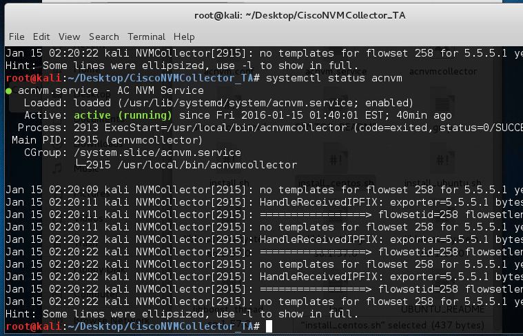

I Installed this collector in a Kali Linux Box i had and i keeps showing me that message
no templates for flowset 258 , the exporter is my ip address in anyconnect, i dont know if i supposed to use another centos box, the conf file is configured to send the syslog to the right ip address but there s no info there
vijvenug
Hi edufernandez2,
Did you install the collector ? The collector is a daemon service that needs to be installed on the server that your client profile is pointing to. The instructions to install the collector are available under the "Help>Install Guide" section on the Splunk App.
Also, please note that the collector can only be installed on Linux 64 bit machines.
-Vijay
