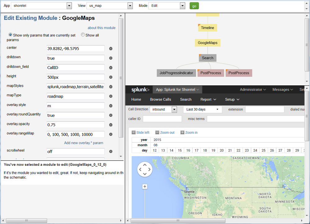

Yes but only if you use the old GoogleMaps module in the Google Maps app . Here's a screenshot of the Sideview Editor editing a GoogleMaps module downstream from a large number of other modules like TextFields and Pulldowns.
If you're comfortable with the old GoogleMaps module it's pretty straightforward. On the other hand if you're looking to use the newer map functionality from Splunk I'm afraid that's not possible in the Sideview Editor nor using the Sideview XML.
(By the way and in case you're wondering, what you see here downstream from the GoogleMaps module is part of custom drilldown functionality we have in this particular page. )

You do not need to downgrade the Google Maps app. I had referred to the "old" Google Maps app in my answer but I just meant old in the sense that these days there are also other ways of using maps in your dashboards. The latest Google Maps app will work great with the Sideview Editor.
