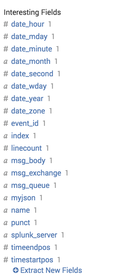

Damien_Dallimor
Ultra Champion
Probably simplest to just do a custom field extraction in Splunk Web.
Follow the "Extract New Fields" link.
marcusnilssonmr
