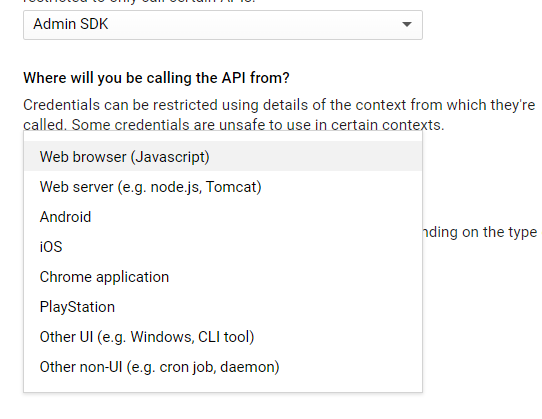

splunk24
create client id lands mein to this option
Application type
Web application
Android Learn more
Chrome App Learn more
iOS Learn more
PlayStation 4
Other
but i want data from g drive only? then which one to select
splunk24
and what to be enter here
Enter JavaScript origins, redirect URIs or both
Authorised JavaScript origins
For use with requests from a browser. This is the origin URI of the client application. It cannot contain a wildcard (https://*.example.com) or a path (https://example.com/subdir). If you're using a non-standard port, you must include it in the origin URI.
Authorised redirect URIs
For use with requests from a web server. This is the path in your application that users are redirected to after they have authenticated with Google. The path will be appended with the authorisation code for access. Must have a protocol. Cannot contain URL fragments or relative paths. Cannot be a public IP address.
