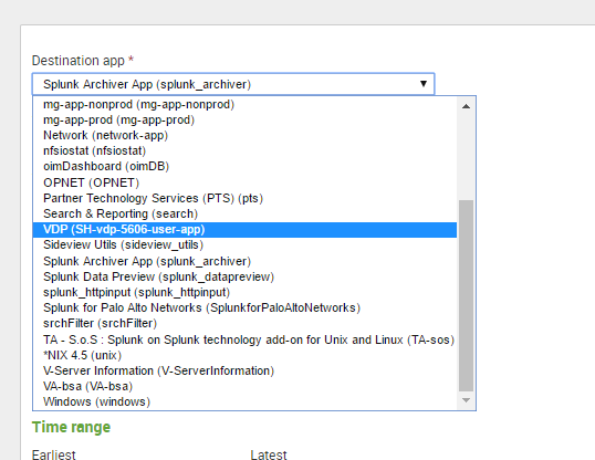

Thank you for the response.
Where can i find the option/label to set to "Shared in APP" while creating the alert. And also in Run as what difference if we select "Owner or user"
