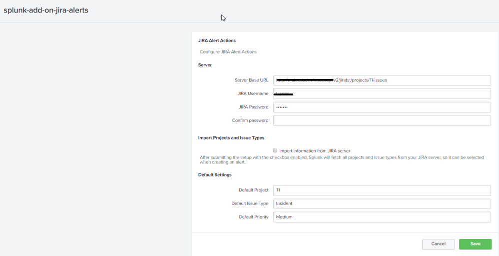

Hi,
we are trying to create JIRA tickets via Splunk alerts.
I have installed "Splunk Add-on for Atlassian JIRA Alerts"
https://splunkbase.splunk.com/app/2888/#/details
In our case we can't directly create JIRA tickets, there is one 3rd Party app, which accept input in JSON format. Not sure if its possible to implement.
Request Format which require to Create JIRA via 3rd Party APP.
Please find below the details needed to create jira issue for TI project:
-   URL: http://***/jiratst/projects/TI/issues
-   Method: POST
-   Credentials as Basic Authentication:
-   Username/Password: ***/***
-   Body
      "summary": "Test to create TI issue from mule",
      "description": "Mule Testing Jira Api one level of Module",
      "type": "Incident",
      "priority": "3-Medium",
      "reporter": "ag",
      "moduleMapLevels":{"parent":"Common to All Modules"},
      "moduleMapAssets": [{"name":"Rates | IRD"},{"name":"CRD | CRD"}]
I have setup JIRA alert with these details.
When alert is triggered I am reciving this error in splunkd.log
03-13-2019 13:19:12.069 +0100 INFO  sendmodalert - action=jira STDERR -  Jira server HTTP status= { "message": "Resource not found" }
03-13-2019 13:19:12.069 +0100 INFO  sendmodalert - action=jira STDERR -  Jira server response: { "message": "Resource not found" }
Thanks
