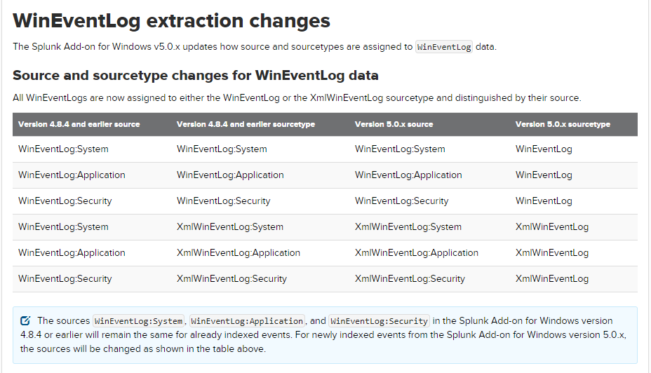

This is probably because of Source and sourcetype changes for WinEventLog data in newer version which you installed accidentally.
Due to this change, events that have already been indexed (by latest version TA) will have WinEventLog as sourcetype name. Add a wildcard to sourcetype in your reports and searches, so that splunk can search both version sourcetypes.

Yes, this issue is because of sourcetype changes for WinEventLog data in latest Splunk add-on for Windows.
If you are getting data using Splunk_TA_windows latest version(v5.0.1) then query sourcetype="WinEventLog:Security" won't work.
Reason: In Splunk_TA_windows v5.0.x, Source types WinEventLog:* are merged and all the WinEventLog Data would be populated in a common "WinEventLog" Source type and would be differentiated by sources (which is unchanged).
That's why query (source="WinEventLog:Security) is working.
Solution: If you have reinstalled Splunk_TA_windows v4.8.4 then check if inputs are properly configured and props.conf and transforms.conf changes are reverted on forwarder as well as SH/IDX.
Note: The add-on Splunk_TA_windows v5.0.x is not compatible with Exchange app 3.4.x.

I don't think changing props.conf will help.
If we think this through, you were using v4.8.4 for which sourcetype is WinEventLog://<application>|<System>|<Security> then, the latest version for which all sources (app, sys, sec) are assigned one sourcetype WinEventLog then rolled back to v4.8.4. So, you're having a mixture of old and new sourcetypes for the events.
My suggestion is continue searching on source="WinEventLog:Security" in searches or reports or locate and modify savedseaches.conf (all your searches and reports and alerts are saved in this file) to include * in sourcetype name inside searches.
