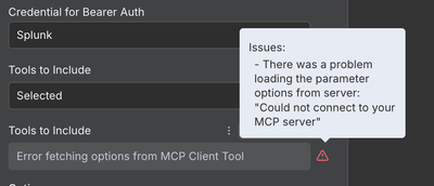

Hello Splunk Community 🙂,
I am trying to use the following MCP Server : https://splunkbase.splunk.com/app/7931 on my Splunk On-Prem Docker deployment,
The application is installed successfully, the token was created for the admin role, and connectivity is ok between the MCP Client and the MCP Server :
xvalette@XVALETTE-M-06WY ~ % curl -X GET "https://splunk-xvalette.com/services/mcp" \
-H "Authorization: Bearer MY_ADMIN_TOKEN"
{"message":"Method not allowed"}
 However, I am getting an error "Could not connect to your MCP server" on the N8N MCP Client :
I am able to connect to other MCP Servers, so the N8N configuration seems okay,
Is there any step that I am missing to make this work ?
Thanks for your help,
Xavier

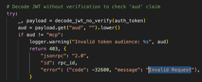

I just fix my situation,
The audience should be "mcp",
I saw this while checking the code :
Hope it will help !
