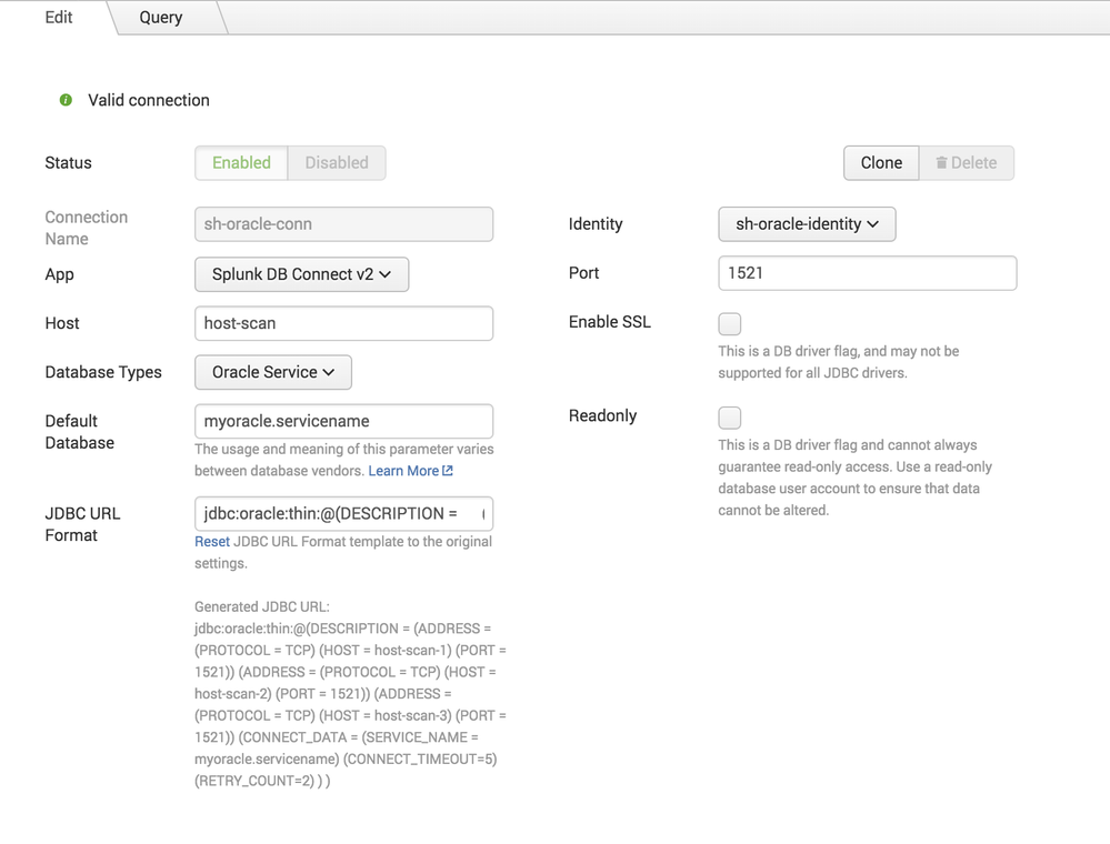

If you are using multiple SCAN, san host-scan-1.com and host-scan2.com. You need to specify the URL by your self in JDBC URL Format, see below screenshot. For example:
jdbc:oracle:thin:@(DESCRIPTION =
     (ADDRESS = (PROTOCOL = TCP) (HOST = host-scan-1) (PORT = 1521))
     (ADDRESS = (PROTOCOL = TCP) (HOST = host-scan-2) (PORT = 1521))
     (ADDRESS = (PROTOCOL = TCP) (HOST = host-scan-3) (PORT = 1521))
     (CONNECT_DATA =
         (SERVICE_NAME = myoracle.servicename)
         (CONNECT_TIMEOUT=5)(RETRY_COUNT=2)
Hope this would help
     (CONNECT_DATA =
