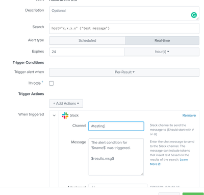

Hello,
I'm trying to add msg value to slack and email trigger alert but I'm getting the first word of msg field.
I would like to get the full message.
here's the search results:
here's the slack trigger: I used $results.msg$

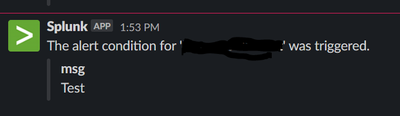

this is what I get:
now, I want to get the full message.
instead of "Test", I want to forward the full message from msg field: "Test message generated successfully"

@danan,
It doesn't seem to take the msg field but the literal "msg" from your token.
Use $result.msg$ instead of $results.msg$
Please be reminded that the filed values are limited to first value for the specified field name from the first search result row. Also make sure that the field is available(fields a,b,c,) in the result set especially if its an extracted field

@renjith_nair ,  I've changed to $result.msg$ but still, it presents only the first word.
maybe there are other ways to get the full message instead of the first word?

@danan, in your screen shot (between host and sourcetype), it extracts "Test" as a value in msg. You shall try adding quotes around the message to treat them as a single field , e.g. "Test message generated ....".
