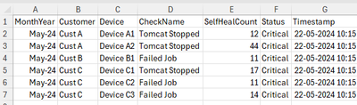

Hello, I have an alert setup which reads a lookup file (populated by another report) and if there are any records in the lookup file, emails should be triggered (one for each record).
I understand this can be done using trigger "for each result" but I want to use some field values from each record and use it as an email subject.
Example:
in this case, I want 6 emails to be triggered with subject lines as,
Email 1: Selfheal Alert - Cust A - Tomcat Stopped - Device A1- May-24 - Device Level
Email 2: Selfheal Alert - Cust A - Tomcat Stopped - Device A2- May-24 - Device Level
Email 3: Selfheal Alert - Cust B - Failed Job - Device B1- May-24 - Device Level
Email 4: Selfheal Alert - Cust C - Tomcat Stopped - Device C1- May-24 - Device Level
Email 5: Selfheal Alert - Cust C - Failed Job- Device C2- May-24 - Device Level
Email 6: Selfheal Alert - Cust C - Failed Job - Device C3- May-24 - Device Level

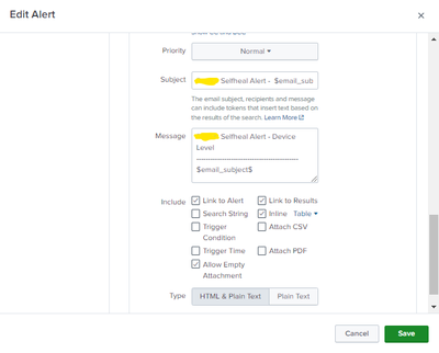

I have created this email_subject field and when used within Email Body $email_subject$, it worked fine but not when used in Email Subject. Can you please suggest if I am missing something?

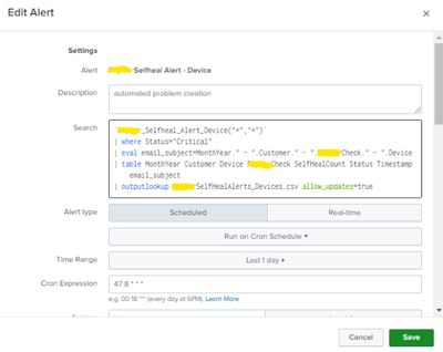

| eval email_subject=MonthYear." - ".Customer." - ".CheckName." - ".Device

If it doesn't work put an image from edit alert section of your alert hear
madhav_dholakia
Contributor

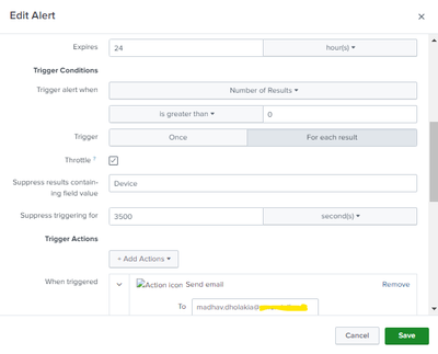

Hi @marysan - please see attached screenshots for Alert Configuration.

Here's what you should put in the alert's config to achieve what you want:
Search:
| inputlookup <file>
Subject:
Selfheal Alert - $result.Customer$ - $result.CheckName$ - $result.Device$ - $result.MonthYear$ - $result.Status$
Trigger: For each result
Throttle: [check]
Supress results contain-ing field value: Device
(This will prevent Splunk sending out duplicate alerts for the same device)
Suppress triggering for <some time period>. Set this for however often your lookup-populating report is scheduled to run
madhav_dholakia
Contributor
thanks @KendallW - I think $result.field$ will not work in this scenario? I am already using he subject line as you mentioned but it is having a blank value (in Email I receive) for the variables.
