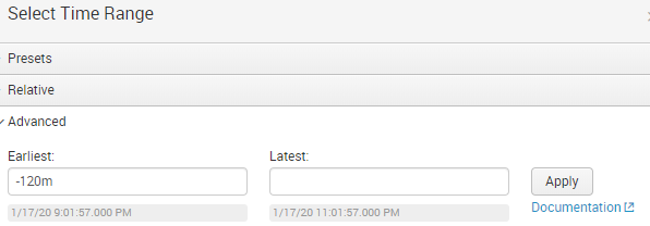

I have the following alert setup
With custom time range:
So looking at results in the last 2 hours.
I expect to receive an alert if there are zero results in the last 2 hours from 8am to 4pm, Monday to Friday.
However I am receiving an email at every interval (8am, 10am, 12pm, 2pm, 4pm), Monday to Friday.
And of course, I have manually run the query for the exact time frame which yields results.
Not sure where I have gone wrong...so I'd appreciate if anyone can help!

@icodebro - You can check in your Activity->Job , search your job name and in Actions , click on Job, Inspect job and you can see the count of results and search log. Also you can click on the job and see the results for last 2 hrs.
icodebro
New Member
The job inspector does indicate no results.
I then opened the search query from the job list, which also says no results found.
Now on that same page, without modifying any part of the query, I click search (magnifying glass), results are returned.
Any idea why I get different results?
Logs are ingested in real time because I get results even before the alert if fired.

can you share your search, masking anything sensitive? Some thoughts....
Have you looked in the _internal or _audit index for this saved search to confirm that it did in fact return 0 results before firing the alert?
Is this data being ingested in real-time? Meaning, for that 2 hour period, is the data definitely in Splunk at that time? Or is maybe ingested every 3 hours or something like that?
Do you have any knowledge objects (field extraction, lookup, etc.) used in your search that may not be available to the search due to permissions or which app they're in, etc.?
