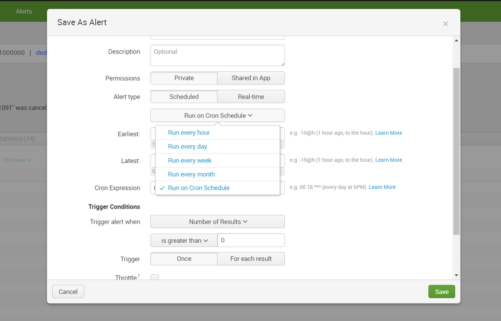

Is this possible? I'm having difficulty finding an options in the 'edit alert' page to further fine tune the cron schedule so that I can set an actual start time.

here is how to manually edit cron to whichever expression you would like under the save alert popoup:
