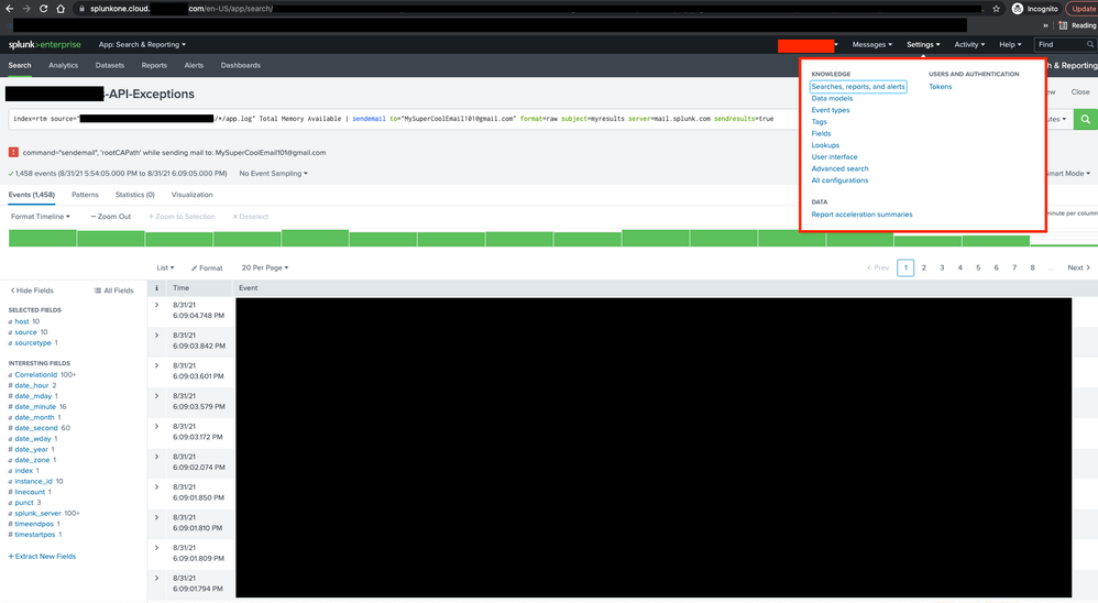

I'm trying send an e-mail from my Splunk Search Alert (I am using SPLUNK Enterprise), but I'm getting an error message "command="sendemail", 'rootCAPath' while sending mail to: [email protected]" and when I try a solution that involves going to Settings to Add a Role, I don't see that option listed at all.
My search query is something like (reference https://community.splunk.com/t5/Reporting/How-to-get-Splunk-sendemail-command-to-send-multiple-email...)
index=rtm source="/mypath/app.log" SomeRandomTextHereForTesting | sendemail to="[email protected]" format=raw subject=myresults server=mail.splunk.com sendresults=true
I found this post which suggests adding some "list_settings" role by going to Settings > Access Controls > Roles, but I do not seem to have that option (reference https://community.splunk.com/t5/Reporting/splunk-dashboard-cant-sent-email/m-p/489388)
Screen Shot 2021-08-31 at 1.09.27 PM.pngScreen Shot 2021-08-31 at 1.09.27 PM.png
Am I doing something wrong? Is this because I'm on Splunk Enterprise? Am I using the correct mail server? How do I add ROLES?

To define roles (add capabilities to a role) you have to be an admin.

Well, you can have an action "send email" in alert definition but the email settings for your Splunk Enterprise instance must be specified by the admin. If your Splunk instance was not configured for sending email, it's either an ommision by the admin or a deliberate choice not to use this functionality. Either way - you should consult your Splunk admin about this.
And it's overally a good idea - a normal user shouldn't be able to (ab)use email sending functionality by trying to send emails via random servers.

Hi, @PickleRick thanks for the help thus far. I reached out to my administrators today and found out I actually indeed do have ADMIN have for this splunk (enterprise).
Am I missing something here? Am I looking at the right spot (based on my first/initial screen shot I posted) for adding a Role, and is this even the correct approach I am taking?
I simply want to send an email through splunk alert.....
PickleRick
Well, that's strange because as an admin you should have additional entries in Settings dialog. Especially the links to manage roles and users.
See for yourself:
https://docs.splunk.com/Documentation/Splunk/8.2.2/Search/NavigatingSplunkWeb
Look at the screenshot of the Settings menu.
In a larger (not all-in-one) environment some settings might not be available but the ones we're talking about should definitely be there (for an admin).
Properly, you should have your email sending mechanism configured under Alert Actions.
Then when defining alert you only need to chose the defined Alert Action.
