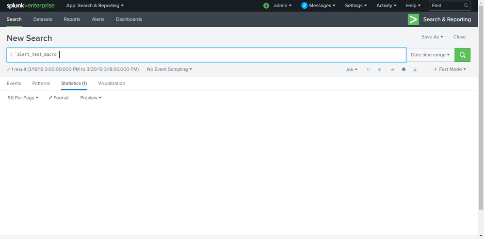

I created an alert using a macro, and confirmed the operation.
Then, the alert trigger operation itself worked well, but when I confirmed the result from "View Results", the result is not displayed for some reason.
Is this due to using macros in alerts?

@yutaka1005
I'm not sure but if all mentioned fields in search (using fields or table command) doesn't have any data then might be stats count showing but not report,
Can you please share definition ?

It is just test, so definition is below.
makeresults count=1 | eval status="aaaaa"
