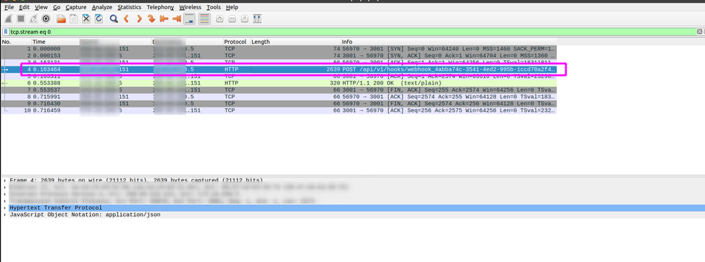

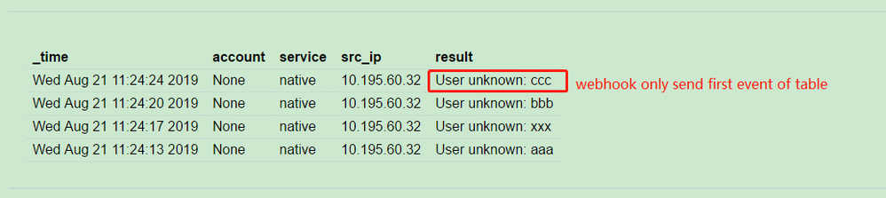

I have an alert that sets 2 actions, sending emails and webhook.

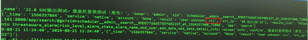

if I set Trigger Condition as once,webhook alert sends only the first row of events in the table.( User unknown: ccc),The following screenshot is the payload sent by webhook alert, which you can see captures only the first line of events
The following screenshot is my e-mail content,my mailbox received an e-mail containing four lines events.
This is not my ideal result.

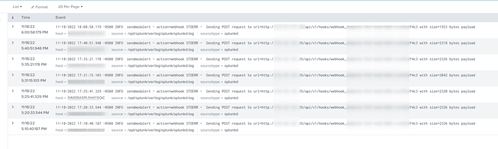

Hello !! Can someone solve this problem? Context, presented the same problem example, a search that runs every 5 minutes, the result is mailed (all 3 events are sent), a notable event is generated (3 notable events are generated), but when reviewing the webhook only receives the first event.
SH internal sendalert
for this example every 5 minutes more than 2 events are generated and only one POST is sent that refers to the first event, but a second request to the webhook is not evidenced
Capture on webhook server only 1 packet received (POST)
Does anyone know how to send multiple events?

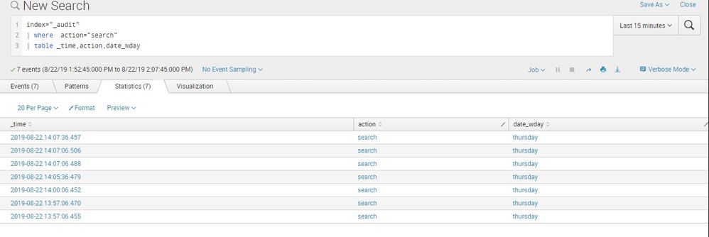

Now, assuming I am running an alert every 15 minutes that checks for action = search and should trigger an webhook alert with the alert results, see screen shot1
index="_audit"
| where  action="search"
| table _time,action,date_wday
our aim is that the webhook should send all results BUT as we know it is only sending the first row.

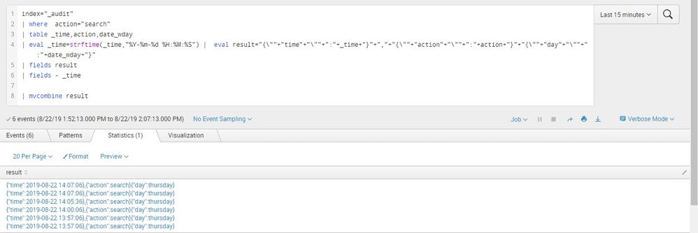

Now, what if I combine all results into 1 single row? webhook WILL send 1 single row.
so the above query becomes something like this, I am using dummy json like formatting,
index="_audit"
| eval _time=strftime(_time,"%Y-%m-%d %H:%M:%S") |  eval result="{\""+"time"+"\""+":"+_time+"}"+","+"{\""+"action"+"\""+":"+action+"}"+"{\""+"day"+"\""+":"+date_wday+"}"
| fields result
| fields - _time
| mvcombine result
Now, this becomes 1 single row in the result, see second snap
Now when you use webhook this will return you all results in a json like format , since now we have just 1 row.
For the moment forget about the formatting of the result string,rather try to see if the webhook fires with 1 single multi valued field, which is nothing but the combination of all alert results, made into a single field.
You will have to retrofit your results a bit or if you can use the _audit index and test the webhook alert, that also should be fine

yes, I am sure, don't know if you understand what I mean? sorry, my English is not good. I mean is that when an alert is triggered, the alert result returns a multi-line event (e.g., three results), and the webhook sends only the first line event result. but my email received a complete list of events(i.e., mail containing three results)
index=xxxx status=404|table host,source,status
 1.1.1.1   /www/logs/nginx.log  404
 2.2.2.2  /www/logs/nginx.log  404
 3.3.3.3 /www/logs/nginx.log  404
webhook send only the first line of results 1.1.1.1 /www/logs/nginx.log 404, But the received alert mail message contain three lines of event record

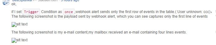

ok,
So I want to solve this problem. I hope webhook alert can send payload containing the entire search results (4 events in a table). But I don't want to merge them into one line through stats or any other command.
in addition. I can't set Trigger Condition as For each result,otherwise, it will be an email bomb, which constantly sends me emails, each containing the result of one line of events, that is, when the alert triggers, sendemail will be split into four emails and sent to me.
Do custom alerts require development ability? Do I need to do a lot of development work?

Firstly, webhook alert will not send consolidated results refer here - https://docs.splunk.com/Documentation/Splunk/7.3.1/Alert/Webhooks
see this section in the above document
Webhook data payload
The webhook POST request's JSON data payload includes the following details.
Search ID or SID for the saved search that triggered the alert
Link to search results
Search owner and app
First result row from the triggering search results
can you please upload the images
