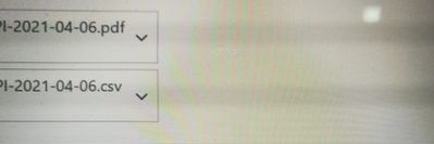

As part of the alert I have created I am sharing the pdf, how can I share the pdf with date range (that is from start - end date)
 in the image you can see that as part of alert I am sharing the pdf which contains 1 week data (29-3-2021 to 5-4-2021)but my pdf which is shared today gives today's date as pdf title is there anyway that I can have the date range as a pdf name and not the current date as pdf name @mayurr98 @aasabatini
