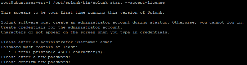

FYI: There seems to be no default username - you're required to enter one during the initial set-up.
Anyway, I set up the following new environment:
  • OS: Ubuntu Server 20.04
  • Splunk: Enterprise (full 2-month trial) 8.1.0
  • Username: admin
  • Alert owner: nobody
  • Email server: smtp.office365.com:587
I have not yet seen the aforementioned errors.
I re-added the logging which reported a URI of uri: /servicesNS/splunk-system-user/TA-<app name>/saved/searches/<alert name>
Why this is different and works, I'm not sure at this point but I'll look into it further tomorrow.
