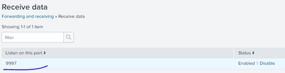

Hello everyone,
I have set up my Splunk server[with receiving port 9997 is enabled] and Splunk forwarder to monitor my UF logs.  Please suggest what i am missing here.

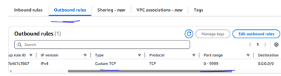

I see you have put a screenshot of the rule that allows inbound traffic to your server, but is your UF server also configured with outbound connectivity on port 9997?

Hi @gcusello,
as per your comment, yes my UF has outbound rules set on port 9997, still not working. Please suggest

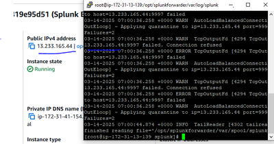

telnet: connect to address 13.233.165.44: Connection refused
and splund.log
please suggest.

here is the output
[root@ip-172-31-13-139 log]# nc -vz -w1 13.233.165.44 9997
Ncat: Version 7.50 ( https://nmap.org/ncat )
Ncat: Connection refused.
no  my outputs.conf is below:
[tcpout]
defaultGroup = default-autolb-group
[tcpout:default-autolb-group]
server = 13.233.165.44:9997
and when i debug splunkd.log
The TCP output processor has paused the data flow. Forwarding to host_dest=13.233.165.44 inside output group default-autolb-group from host_src=ip-172-31-13-139.ap-south-1.compute.internal has been blocked for blocked_seconds=100. This can stall the data flow towards indexing and other network outputs. Review the receiving system's health in the Splunk Monitoring Console. It is probably not accepting data
please suggest
