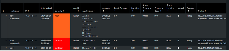

So  i have a dashboard and in drilldown i am showing severity in the servers now i want whenever the severity is solved that severity is removed from the drilldown and store somewhere else for confirmation.
from this table if i solve any severity i should be able to remove it from here and store it somewhere else.

ok so i have a drilldown
so in this table there is a field solved which have default value 0 which means this particular severity is not solved . Now i want a button instead of 0 .like this
now whenever a severity is being solved then when we click on this button it should change like this
and this specific result  its value (solve field ) should be changed to 1.
