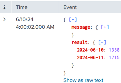

Hi Community,
actual i have a cron job, thats get every day values for today and tomorrow.
How to extract for "today" or "tomorrow" the value?
This SPL doesn´t work, and don´t  rename my field to get a fix fieldname...
| eval today=strftime(_time,"%Y-%m-%d")
| rename "result."+'today' AS "result_today"
| stats list(result_today)

Iterator command foreach is your friend. (I do not recommend treating structured data as text.)  One strategy could be iterate on field name:
| foreach result.*
    [eval today = mvappend(today, if(strftime(now(), "%F") == "<<MATCHSTR>>", '<<FIELD>>', null())),
    tomorrow = mvappend(tomorrow, if(strftime(now(), "%F") != "<<MATCHSTR>>", '<<FIELD>>', null()))]
BTW, illustrate raw JSON in text, do not use screenshot and do not use Splunk's contracted format.  Using @KendallW's makeresults emulation, you get
_timeresult.2024-06-10result.2024-06-11todaytomorrow
2024-06-10 23:59:391338171513381715
Tags (1)

Hi @CMEOGNAD
Assuming that today's date will always be the first element of result and tomorrow the second, you can do this:
```adding sample data```
| makeresults
| eval _raw="{
     \"result\" : [
         {\"2024-06-10\" : 1338},
         {\"2024-06-11\" : 1715}
```using spath to extract values```
| spath output=today path=result{0}.
| rex field=today "\{\"(?<todayDate>[^\"]+)\"\s\:\s(?<todayResult>\d+)"
| spath output=tomorrow path=result{1}.
| rex field=today "\{\"(?<tomorrowDate>[^\"]+)\"\s\:\s(?<tomorrowResult>\d+)"
This gets you the todayResult and tomorrowResult values extracted with regex.
Ideally, you could extract the values directly with spath, but it seems it's not possible to use a variable for the path in spath, e.g.
| eval today=tostring(strftime(_time,"%Y-%m-%d"))
| spath input=today output=today path='today'
 hope this helps.
