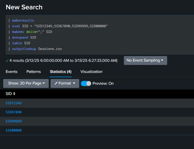

To test it, Generated a "Sessions.csv" file using makeresults and outputlookup.
| makeresults| eval SID = "SID12345;SID67890;SID99999;SID00000"
| makemv delim=";" SID
| mvexpand SID
| table SID
| outputlookup Sessions.csv
This creates a CSV file named Sessions.csv with a single column SID containing the session IDs.

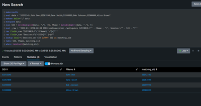

Final Query:-
  • mvindex(split(data, ","), 0) extracts the first part (SID).
  • mvindex(split(data, ","), 1) extracts the second part (FName).
  • Ensures correct lookup matching before filtering

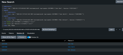

| makeresults
| eval data = "SID12345,John Doe;SID67890,Jane Smith;SID99999,Bob Johnson;SID00000,Alice Brown"
| makemv delim=";" data
| mvexpand data
| eval SID = mvindex(split(data, ","), 0), FName = mvindex(split(data, ","), 1)
| eval _raw = "2025-03-13T10:00:00 INFO hostname=prod* /api/update CUSTOMER:\"" . FName . "\", Session:\"" . SID . "\""
| rex field=_raw "CUSTOMER:\"(?<FName>[^\"]+)\""
| rex field=_raw "Session:\"(?<SID>[^\"]+)\""
| lookup local=t Sessions.csv SID OUTPUT SID as matching_sid
| table SID, FName, matching_sid
| where isnotnull(matching_sid)
