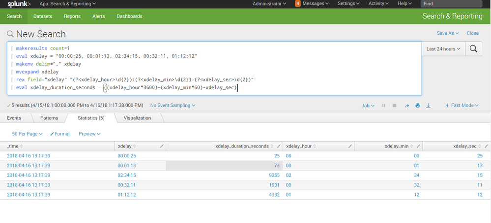

hello there,
assuming you captured the values for the field xdelay you can try something like this, run it anywhere:
| makeresults count=1
| eval xdelay = "00:00:25, 00:01:13, 02:34:15, 00:32:11, 01:12:12"
| makemv delim="," xdelay
| mvexpand xdelay
| rex field="xdelay" "(?<xdelay_hour>\d{2}):(?<xdelay_min>\d{2}):(?<xdelay_sec>\d{2})"
| eval xdelay_duration_seconds = ((xdelay_hour*3600)+(xdelay_min*60)+xdelay_sec)
now calculate however you want, for example:
| timechart span=1m avg(xdelay_duration_seconds) as avg_xdelay
checkout below screenshot:
hope it helps
