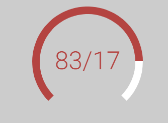

@Deepz2612 try the following run anywhere example. It does the following:
1) Runs an independent search (search without visualization), to get the Success and Failure rate.
2) Using Search Event Handler sets the tokens for Success Rate and Failure Rate.
3) Inside the Horseshoe custom visualization, use run anywhere search and display one of success or failure token based on which Radial Chart needs to be drawn using corresponding token set in the previous step.
4) Use the tokens to display the Caption text as expected.
5) Give an id to the horseshoe meter and use CSS Selector to
a) Hide actual horseshoe meter text using CSS selector.
b) Change the font and position of the caption position to override the actual value position and font.
Following is the complete code for the run anywhere example as per your use case:

Please try out and confirm!
Deepz2612
Hi,
I tried the above and receiving the error as below.
Error rendering Horseshoe Meter visualization: This visualization cannot render non-numeric results. To build a horseshoe meter visualization, use a search that returns numeric values.
niketn
Legend
@Deepz2612 Did you get issue with run anywhere example or your own implementation?
Did you print the value of $tokFailure$ which is used in Horseshoe Meter? Is it numeric?
