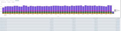

livehybrid
Hi @SN1
You can modify the search below to use the metrics.log to get this information, update the series= value with the index name you want to look at, and you may also want to exclude your indexer(s) as these also collect the metrics on index thruput
index=_internal series=YourIndex group=per_index_thruput host!=YourIndexer*
|  eval gb=kb/1024/1024
|  timechart sum(gb) AS gb by host
This will give a chart showing the GB of data for each forwarder.
Please let me know how you get on and consider upvoting/karma this answer if it has helped.
Regards
Will
