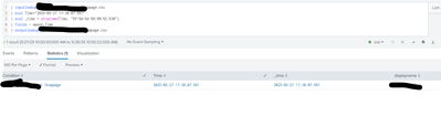

smanojkumar
Contributor
Hello @gcusello & @PickleRick ,
Thanks for your time!
I have converted both index time and Lookup time to epoch. It seems perfect with makeresults but while I'm using index data the time stamps were changed to an another new value in the search,
I herewith attched the snap of makeresults where its workign fine, and the other snaps as well,
Please let me know if i missed anything.

smanojkumar
Contributor
Hi @gcusello ,
As you see in 3rd screenshot, the smaple time that i have ingested is 2025-05-27 17:38:07.991, but in the 2nd screenshot the time stamp chnaged to 2025-05-23 05:25:50.795 in the field name Loo_time in the results , I dont know the reason.
also I have use only epoch time from the lookup while comparing with index data which is already in epoch time.
This was my only concern, Can you please help me to fix this.
