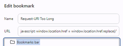

For the second option, you can make a "Bookmarklet" that removes all of the URL parameters except the SID:
 javascript: window.location.href = window.location.href.replace(/\?.*?(\bsid=[^&]+).*/, '?$1')
Note: Khoros is breaking the bookmarklet; replace : with :
If you click on that bookmarklet when you get the error, it will open the search.

I made a couple more bookmarklets to help:
1. SID Only: Strip all URL parameters except the SID to have the search parameters loaded from the saved job (only works if the SID is still saved)
javascript: window.location.href = window.location.href.replace(/\?.*?(\bsid=[^&]+).*/, '?$1');
2. Show Search: Show the search after the error message
javascript&colon; query_str = decodeURIComponent(window.location.href.replace(/.*?\bq=([^&]+).*/, '$1')); document.body.innerHTML += `<pre>${query_str}</pre>`;
3. Strip off different parameters until it works. 1st click removes the display fields list, 2nd click collapses repeated spaces, and 3rd click truncates the query to 3500 characters.
javascript&colon;(function(){if (location.href.indexOf('display.events.fields')>=0) {window.location.href = window.location.href.replace(/\b(display\.events\.fields=[^&]+)/, '');}else if (location.href.indexOf('%'+'0A')>=0) {window.location.href = window.location.href.replaceAll(/(%(20|0A))+/g, ' ');}else{window.location.href = window.location.href.replace(/(\bq=[^&]{100,3500})[^&]*(.*)/, '$1$2');}})();
Again,  replace the "&colon;" in the blocks above with the colon character.

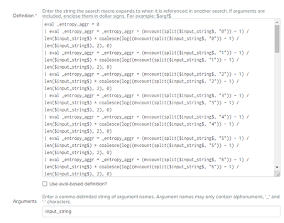

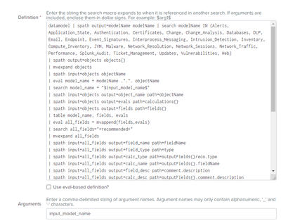

In that case, each macro can contain a very large number of commands. When possible, I create macros that are reusable, but that is not always appropriate. In particular, Splunk Enterprise Security content includes a separate filter macro for each Correlation Search so that false positives can be tuned out without editing the detection core logic.
Without access to your search query, it is difficult to know how to make the search smaller.
In a Windows browser, you can press Ctrl-Shift-E when writing your search to show the "Expanded Search String" with the content in all of the macros being shown.
These are a couple examples of how I've moved long parsing and calculation strings to macros:
get_datamodel_desc(1)
entropy_digits_lowercase(1)  (the Decrypt2 app is better than this macro)
