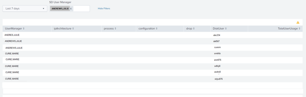

cblanton
Communicator
DiskUser is irrelevant.
I just want to look up all the corresponding UserManagerxn for the token selected UserManager and append the search with UserManager=UserManagerxn.
cblanton
Communicator
So if I try this, with my pretend csv. If the token passes NOBEL,ALFRED as the UserManager I expect to get all search results with NOBEL,ALFRED as UserManager plus PAGE,LARRY and MEAD,MARGARET, but instead I get only NOBEL,ALFRED and ROGERS,FRED. So it's finding the match in the UserManagerxn field and returning the UserManager, instead of matching the UserManager and returning all the UserManagerxn.

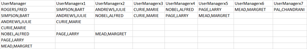

to4kawa
Ultra Champion
sdmanager.csv
UserManager,UserManagerx1,UserManagerx2,UserManagerx3,UserManagerx4,UserManagerx5,UserManagerx6,UserManagerx7
"ROGERS,FRED","SIMPSON,BART","ANDREWS,JULIE","CURIE,MARIE","NOBEL,AFLRED","PAGE,LARRY","MEAD,MARGRET","PAL,CHANDRANI"
"SIMPSON,BART","ROGERS,FRED","ANDREWS,JULIE","CURIE,MARIE","PAGE,LARRY","MEAD,MARGRET",,
"ANDREWS,JULIE","CURIE,MARIE",,,,,,
"CURIE,MARIE",,,,,,,,
"NOBEL,AFLRED","PAGE,LARRY","MEAD,MARGRET",,,,,
"PAGE,LARRY",,,,,,,
"MEAD,MARGRET",,,,,,,
I create the csv and lookup.
The following is my perception
  1. DiskUser specifies UserManager.
  2. UserManager has UserManagerx n , so also display the UserManagerx n DiskUser
  3. Select a specific UserManager from the dashboard

cblanton
Communicator
DiskUser does not specify UserManager. DiskUser is a field in the indexed data and no more relevant to the search than any other field that I'm tabling, like configuration process DiskUser... UserManager is a field in the indexed data and in the lookup table that has matching names.
I only need this simple search to run for the selected manager and then append the same search with each UserManagerx*n* from the lookup. And none of the fields I'm tabling are null.

to4kawa
Ultra Champion
Can you provide your csv sample?
cblanton
Communicator
UserManager UserManagerx1 UserManagerx2 UserManagerx3 ... UserManagerx20
LAST,FIRST LAST,FIRST LAST,FIRST LAST,FIRST LAST, FIRST
The dashboard input selects from all names listed as UserManager. I need corresponding user data for UserManger/DiskUser pairs for all existing UserManagerx#.
Thanks

cblanton
Communicator
UserManager is a field in the lookup and in the index.
DiskUser is the employee name, a direct report to the manager, and a field in the indexed data
Each LAST,FIRST is a different name.
So if UserManager Andrews,Julie is chosen in the drop down, I want to return all events where she is the manager and also all the managers that report to her, listed in the lookup as UserManagerx1 and so on.
