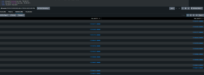

I extracted 2 fields called 'Resp_time' and 'Req_time'...Both these fields are integers.
I also changed the values to epoch
How do I display the difference between the Resp_time and req_time?
