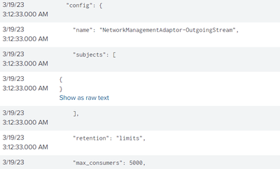

Thanks @gcusello, the main problem I am seeing that on splunk logs. The json file is not showing in one line. Each attribute is on individual line and Splunk is considering each line as separate log. See below example. I am looking to pull config.name field, similarly others.
PickleRick
So the first thing for you is to sort out the data onboarding so that the input stream is properly broken into whole events.
Post in Getting Data In section if you need help with that.

Hi @drogo,
in your props.conf, for your sourcetype you have to configure
SHOULD_LINEMERGE = true
i this way the rows are grouped in events and not each row in one event.
Then you should configure
INDEXED_EXTRACTIONS = json
in this way, you'll have all the fields.
Remember to put the props.conf both on Forwarders and Search Heads, and (if you have) also on intermediate Heavy Forwarders.
Ciao.
Giuseppe
PickleRick
No!
Unless there is really no other way, you should _not_ use SHOULD_LINEMERGE=true. It adds unnecessary load to the parsing engine because it runs a huge bunch of heuristic rules to guess where to join already split lines.
It's better to have properly set linebreaker. But that's a topic for another discussion.
Also, blindly turning on indexed extractions without understanding pros and cons instead of relying on search-time parsing is a mistake.
