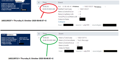

Hi, needs some help with timestamp recognition problem. I have two almost identical events that are sendt over udp to splunk; in one the epoch timestamp is recognized correctly, in the other splunk uses time received. Does anyone have any idea why this is happening?

Timstamp not recognized:
Oct 8 08:40:41 10.0.0.10 1602139237 10.0.0.10:
RemMemTimeStamp : 1602139237
MemoryCookedValue : 0
RemainingMemoryGb : 0
TotalPhysicalMemoryGB : 0
ComputerName : PC01
From powershell:
<134>1602139237 10.0.0.10:
ComputerName : PC01

Are you referring to the part in red below? this is something that splunk must be inserting by it self on ingestion, this is not part of the message sendt to splunk. I have 3 types of near identical events received on this same sourcetype, on 2 of 3 the timestamp recognition works,  can it really be a wrong regex expression?
All 3 events starts the message with timestamp and ip-address, so this is exactly the same on each one, but 1 of 3 is interpreted differently
ComputerName : PC01

Increasing the lookahead  works for timestamp recognition, but it seems like it is this "RemMemTimeStamp : 1602139237" it is recognizing, not the timestamp ahead of it. Would not splunk include it in the event if it was recognized? instead the events start with the remmemtimestamp
Regarding the missing timestamp; it is there...but it seems i used an older image when i posted,  sorry for that.
