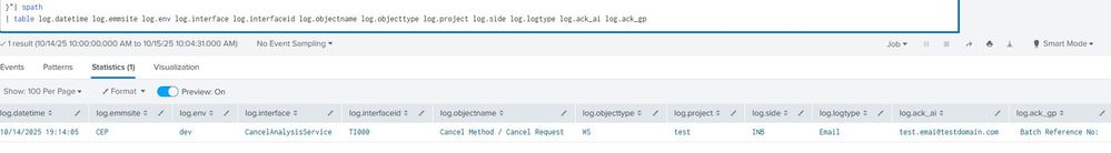

PrewinThomas
Motivator
@chandrasekhar46
Looks like Splunk’s auto JSON extraction is interrupted by the long/escaped message field. Are you using spath in your search?
Can you try using spath
| spath
| table log.datetime log.emmsite log.env log.interface log.interfaceid log.objectname log.objecttype log.project log.side log.logtype log.ack_ai log.ack_gp
or target the specific fields you need
| spath path=log.logtype
| spath path=log.transactionid
| spath path=log.ack_ai
| spath path=log.ack_gp
