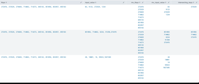

Results show in the screenshot
You can split the comma delimited lists into MV fields and then loop through one of them to individually check if that number exists in another multivalued field. In this example I did this and created a new field 'intersecting_keys' to return the number that exist in both fields.

Thanks - that is a lot more detailed than my solution and I like the intersection - that will be useful for me to help people know what was in there - we often have hundreds of keys returned and to see which ones were retuned is really useful.
