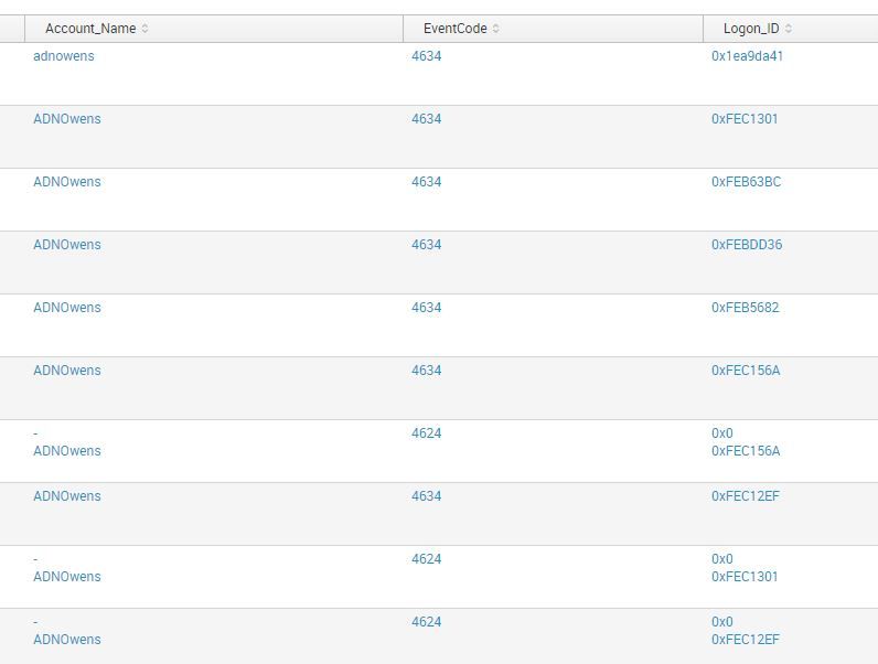

Searching EventCodes for logon and logoff events, LOGON_ID includes 0x0 before actual LOGON_ID. How do I exclude the 0x0?
neiowe
I am trying to build a report that shows how long a user was logged on. To do this, I am trying to match LOGON_IDs for the logon and logoff events. Here's my search code:
((EventCode=4624) OR (EventCode=4634)) AND (Account_Name="ADnowens") |Transaction Logon_ID startswith=4624 endswith=4634 | eval SessionLength= tostring(round(duration/1000,0), "duration") | search SessionLength!="00:00:00" | table host Account_Name SessionLength _time
The problem I am having is that many of the LOGON_IDs have 0x0 before the actual LOGON_ID on the 4624 events. The logoff 4634 doesn't have these so they don't match and the report is not catching them. Any idea how to exclude the 0x0 in the comparison?

So it seems my issue now may be with determining the SessionLength. Rich's solution does seem to remove the 0x0 but my sessionlength is not working correctly. ANy thoughts on what's the best way to determine the time difference between to two events with the same Logon_ID?

I get the exact smae results with or without the | rex mode=sed field=Logon_ID "s/^0x0//" in the search. The screen shots I posted below shows the Logon_IDs. It appears there may be a CR between the 0x0 and the Logon_ID for the 4624 events that would match the Logon_ID for the 4634 event.
neiowe
Actually, this is what it looks like:
It looks like there are two IDs for the 4624 events. 0x0 and the other one below it.
